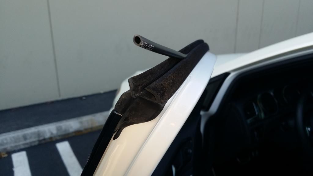

2. Rattle/creak from both front doors (sound ranges from a rattle to creaking to rubbing - overall noisy cabin, especially over uneven pavement or bumps in road).
SOLUTION: Install 1/4" OD black vinyl irrigation tubing between the felt weatherstripping located at the top of both driver and passenger doors.
